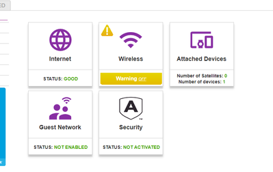

Hello, I have an orbi RBS50 that seems to be shutting down the wifi LAN every couple of hours now for the past few days. When I go into the admin GUI it just shows "warning wireless off". I have po...

I am on the latest firmware for all devices...I did a factory reset and that seemed to fix the issue for a week or so but now its back to its old ways.
The cable modem and physical cables all check out ...it just seems the wireless services turn off on the RBR50 and no way to turn them on...May just have to get a new head end unit...

What is the Mfr and model# of the Internet Service Providers modem/ONT the NG router is connected too? cable modem is connected fine , and a desktop I have plugged into the orbi router is working fine to get a dhcp address and reach the web.
What is the size of your home? Sq Ft? 2700
What is the distance between the router andsatellite(s)? 30 feet or more is recommended in between RBR and RBS ya its 30+
What channels are you using? Auto? Try Auto and 48 on 5Ghz. Or try setting manual channel 1, 6 or 11 on 2.4Ghz and 40 to 48 channel on 5Ghz. Tried this no help
Any Wifi Neighbors near by? If so, how many? yes but they have never been an issue beforethe issue is the wireless service on the router is not coming on and or will not start
