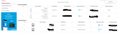

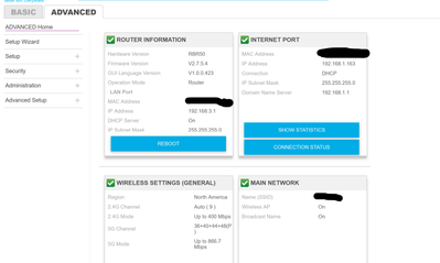

Router settings are:
Connected devices:
Thanks again for the assist.
