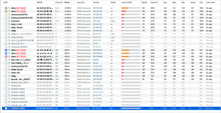

Here's a screenshot from one of the camera's web interfaces that shows the wifi networks and signal strength. At the top of the list it shows my SSID two times. The top one it's connected to shows a signal strength of 100.
