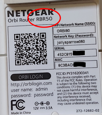

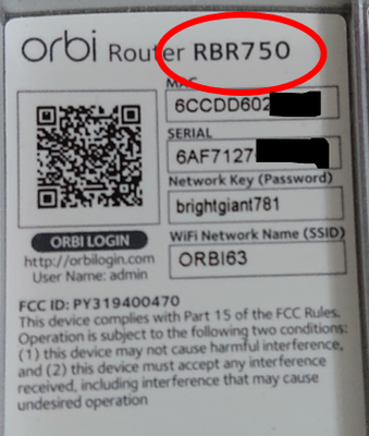

Here are product labels from an RBR50 and RBR750 router:
(oh, well. I'm not having a great day so far, anyway.)
Two things come to mind:
- The Reolink Argus 3 Pro camera does not support WiFi6 (802.11ax). I see no reason why this should be an issue, but there have been reports of other devices failing to work when the WiFi system is set to allow 802.11ax. There is an option on the Advanced WiFi setup page to disable ax. Might be worth a try.
- For sure, the Argus 3 Pro does not support WPA3 security. Only the most recent Orbi models include this security feature, which is the reason for my fixation on the model number.
I also agree entirely that this error seems impossible. The error message does not focus on the password, but on the type of security. When I use a QR Code reader to display the contents of the QR Code, all that is in it is the SSID and the password.
