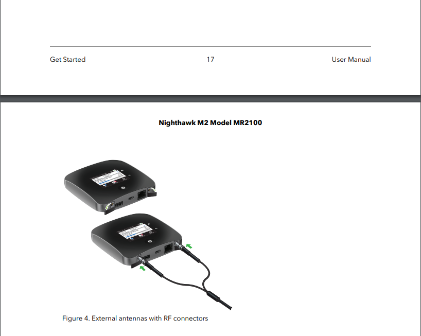

Netgear's always brilliant QA and the Harward Business School fire and forget behaviour 8-/ The MR2100 (M2) manual is a little bit more informative in this aspect.
"External Antennas
Using an external antenna might be recommended in areas of lower coverage to improve
your device performance. MIMO Dual RF antennas are available from your retailer. Insert
the connector carefully to avoid damage to your device."These units (like many earlier AirCard) make use of two radios doing Dual MIMO for the 4x4 system - that's why there are two antennas, and that's why Netgear is offering dual MIMO antennas - at least in some markets. The US site Nighthawk M1 4G LTE Mobile Router - MR1100 | NETGEAR does not list any antenna offer.
The KB MIMO Antenna (6000450) | Product | Support | NETGEAR does point to a data sheet for an indoor antenna MIMO_antenna_DS_07Aug14.indd (netgear.com) from 2014 stating "For complete list of compatible devices please go to:
www.netgear.com/ServiceProviders/AirCardAccessories ... as antinode would say again equally useful 404. I can't understand what they are making all days long 8-(rvtips you can't hurt anything by conncting just one antenna - permitting it's the correct matching connector. If it does help overall with the reception in your use case ... hard to say.
