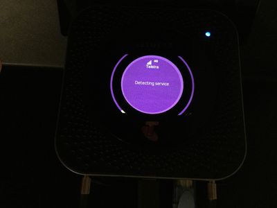

Since NTG9X50C_10.25.01.00 dated 2018/01/31 update available to me on 13 March, there have been mixed blessings. As a fringe-dwelling MIMO antenna user, the Ethernet setting has made life easier. The initial loss of Data Usage info didn’t seem so important. But when it did not come good, I contacted Telstra Support.
Chats with Mobile Assurance SME from 22-24 March yielded a between 3 and 17 factory resets, a couple of SIM card removal/replacements and the obligatory browser refreshes. Yielded a new glitch of blank screen with “Detecting service “ while retaining internet access. Acknowledgement that this constituted a fault.
Outcome: referred to this site
https://www.telstra.com.au/consumer-advice/faulty-products
to submit a faulty device claim. Not believing the offer of an exchange device would be honoured (past experience), I phoned 132200 and an amicable Tech Support said not to fill in the form. They would be sending me an exchange device with a return for old one.
When asked if the exchange device would have the latest firmware installed and working properly he said it would be a new device from the factory, probably with the original firmware and I would have to perform the OTA update to the latest.
When I asked if anyone at Telstra was aware of any Nighthawk M1s that were functioning as advertised since the update, there was silence.
Two hours later he rescinded the exchange. He did not contact me on my preferred landline contact or my second choice iPhone. He left a cowardly voice message using the new Telstra RCS voice service on a device he knew would give me no recall.

It is more than Data Display, after the factory reset/s, connected device display is also gone. This now constitutes minor security issue if using device while away from home.
Connected devices are still available in the Dashboard and App, including LAN. Whitelist is still useful.
Whirlpool forum and Telstra Community forum informed my decision to sit tight and batten the hatches.
With regard to the plan limit setting, Yes and No. The Dashboard Web page has no settings I can find re Data Usage/Plan. But the iOS Mobile App has a Data Usage Button which promises to take us to a Pre-Paid activation service. Not applicable for Telstra Post Paid.
By the way has anyone tried to restore the pointlessly saved export.cfg files because they do not reset personal preferences. They do nothing, at least from a Mac.
