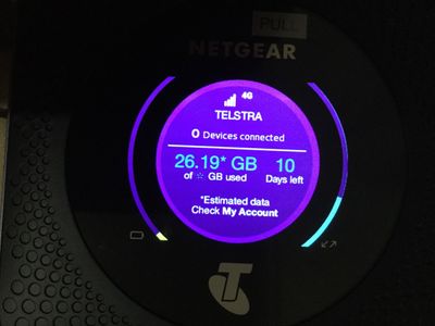

- hippolyteApr 13, 2018Apprentice
The replacement Nighthawk came from the factory with NTG9X50C_10.16.04.04 installed.
Screen is functioning with data usage, not showing ethernet connection, but does show in the dashboard and the iOS app.
NB: asterisk in GB used is my edit
Device is currently reporting NTG9X50C_10.16.04.04 as up to date.
