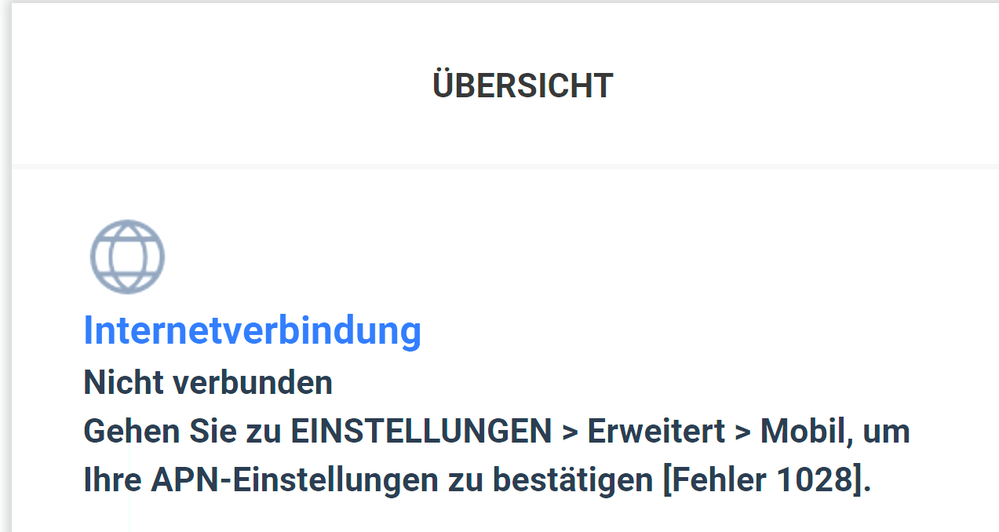

- Darky28Jul 11, 2023Aspirant
Bad luck 😞
I noticed when a lot family members use the router the 512 / 1028 error seems to trigger much faster.
I started a netflix stream on the dell laptop. A netflix stream on the tablet and a plex stream on my mobile phone.. took not long and it crashed with a 1028 error:
- JohnPengJul 12, 2023NETGEAR Expert
Darky28I started a netflix stream on the dell laptop. A netflix stream on the tablet and a plex stream on my mobile phone.. took not long and it crashed with a 1028 error:
Darky28
Here are the details on the 2 error messages. They are related to SIM subscription and network rejects or releases the connection.
512 is PS_NET_DOWN_REASON_ALREADY_IN_TC
This error code is returned when data call is brought down
because traffic channel request got rejected by CM since traffic
channel is already up for voice calls1028 is PS_NET_DOWN_REASON_EMM_DETACHED
Could you please advise the SIM card plan is for data only device? Not sure whether this is also related to roaming agreement between the 2 carriers.
If possible, you can get a cheap pre-paid data plan from the Italian carrier and see whether the device performs differently.
Please also send me another model.json file with the new FW.
Thanks
John
