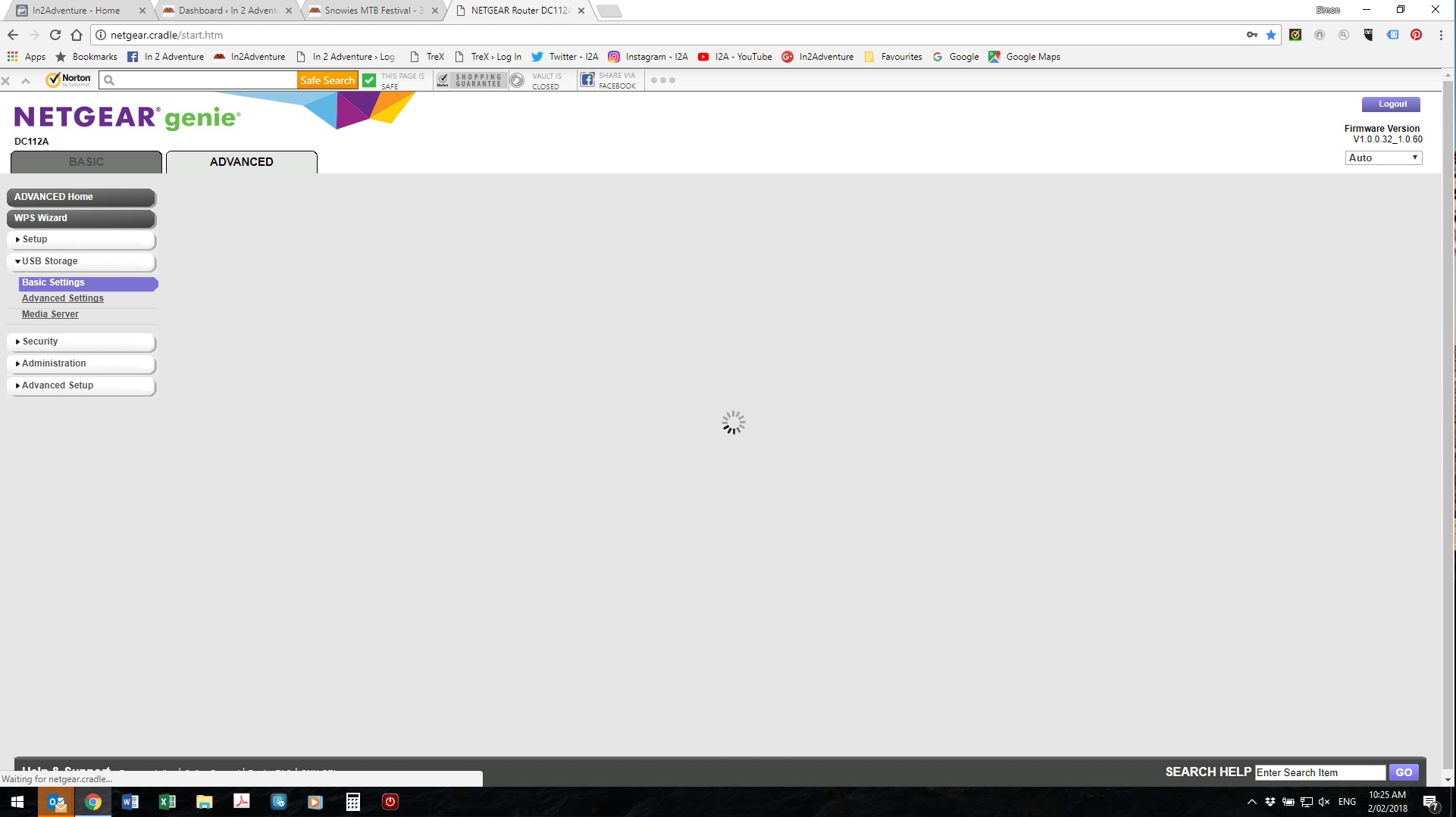

Hi Folks, I have a new AirCard Smart Cradle which I'm using with a AirCard 810S. Internet access is fine but withing 5 minutes of accessing the admin console it locks up. See screenshot, the only way to get out of this is to restart the cradle.

  • So to add to this, by process of deduction it seems that plugging in the USB HDD is the cause of the lockup/freezeing problem.
    Once I unplugged the HDD and restarted the Cradle it has worked fine without any issues.
    But as soon as I plug in a HDD the Cradle will Freeze after approx' 5 minutes.
    During this time I cannot access the HDD even though the Cradle is telling me it is attached as a shared drive.
    Any thoughts?
