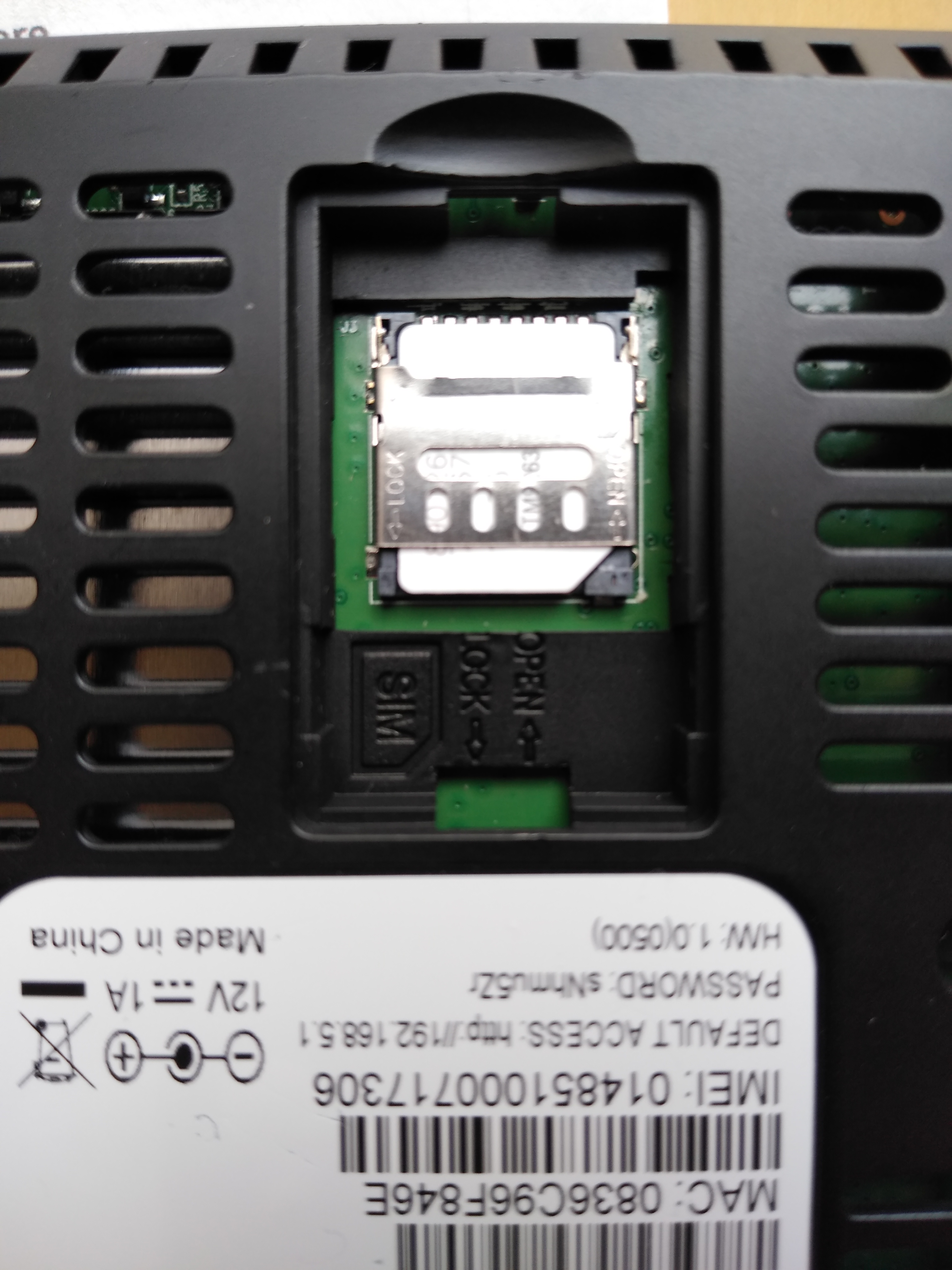

I am getting the SIM insertion error: power LED is blinking amber and the third green LED is solid. I have inserted 4 different micro AT&T and T-Mobile sim cards and none solve this error. All sim cards are active and are brand new.

Community Team- theBrooklingAspirant
I reset the modem to factory defaults (as described in the previious reply)
After reset, the router still does not recognize the T-Mobile, activated (and well-used) data SIM. I have an AT&T data SIM that works just fine in the router. It is the T-Mobile SIM that the modem cannot recognize. 3rd green bar steady, blinking amber.
that data T-Mobile SIM works fine in an Alcatel Linkzone hotspot. The router was purchased to upgrade the hotspot. (that is, the location has T-Mobile signal)
The AT&T SIM works fine in its AT&T hotspot as well as in the LB1120
So, AT&T SIM: recognized by LB1120
T-Mobile SIM: NOT recognized by LB1120
The LB1120 is fresh out of the box. It has not been placed into service, though I did check that it passed data through the working AT&T SIM.
Any ideas?
to be clear, I can always make a mistake.
thank you for your help
