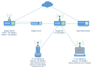

 Hi all,  Is it possible to have the LAN and WAN side of the LB2120 on the same network?  I would only like certain devices to be able to use the LTE backup and to control this by having to set the de...

This will cause an IP conflict. For example, if you set your LAN and WAN to the same IP address then how will you avoid the ip clashing? Also how would you access the LB2120 interface if they both have the same gateway?
If you have the device already, then you can give it a try and confirm. :]

Hi Jason,
-If I had the device I would try it.
-My picture shows the wan and LAN with different IP addresses.
-I would assume only the wan has a gateway as a router uses the wan gateway to pass traffic outside of the lan.
Kev,
