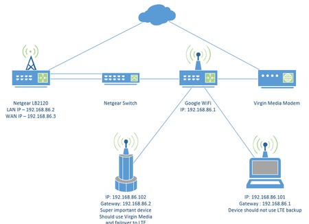

LB2120 - Both nics on the same network
 Hi all,  Is it possible to have the LAN and WAN side of the LB2120 on the same network?  I would only like certain devices to be able to use the LTE backup and to control this by having to set the de...

Hi JumpMaster,
This will cause an IP conflict. For example, if you set your LAN and WAN to the same IP address then how will you avoid the ip clashing? Also how would you access the LB2120 interface if they both have the same gateway?
If you have the device already, then you can give it a try and confirm. :]

Hi JumpMaster,
I have talked to my colleague and he said that your setup should work with the setup below:
Please let us know if this works for you. :]

Hi JumpMaster,
I just wanted to check in on you and see if that diagram worked for you.
Please let me know. :]
