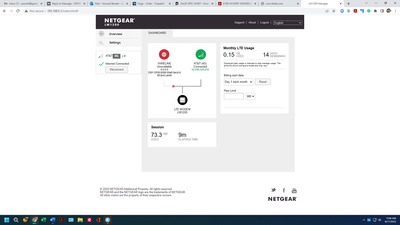

With this setup, it's only running cellular and won't pass through the cable modem. says that the landline ethernet is not
- exxchefAug 17, 2022Aspirant
I can't seem to get the lm1200 to work as a pass-through with the wireline. Im sure it's something simple, but I don't know what it is!
