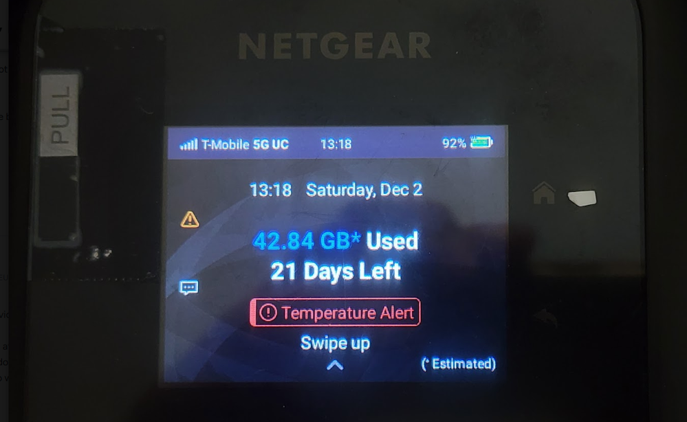

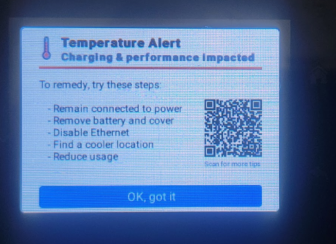

The latest firmware has temperature protection feature.
from my own testing, the battery overheat icon will start showing up at around 49C battery temperature.
the device itself will start showing a temperature alert at around 60C. so they do get hot up to that point. At 60C it will disconnect your device, if it is being used with a battery, it will stop charging as well.
I have used a fan to help the device cool down. it's fall season where I live and the temps have gone down. so I have 44C operating temp right now.
the device firmware should not let the device heat up to 70+C. please make sure you have updated to the latest firmware. Mine is v12.01.54.00. If you are on the same firmware, I suggest you stop using it and have it check at the store where you bought it. If it is truly that hot, then the temp reporting is probably accurate.

Can I ask, where on the device do those temperature alerts appear?
I do not remember seeing that on the device when it was 70+ reported in the online GUI, but also I did not check explicitly.It did not shut down at that time.
I will go to the shop, I guess.
Thanks!- rcpaxOct 21, 2024Luminary
You should see a temperature alert on the LCD
