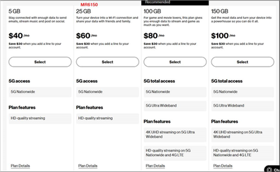

- JohnPengMar 18, 2024NETGEAR Expert
We have confirmed that the following Pre-Paid and Post-Paid Verizon plans will work with MR6550-100PAS and MR6150-100NAS.
Post-Paid
Pre-Paid:
To use Verizon plans, please make sure to have your device upgraded to the latest release with FW version is or newer than 12.01.47.00.
If you don't have active data connection for upgrade, you can try using Ethernet or WiFi offloading to have the device upgraded first before inserting Verizon SIM card.

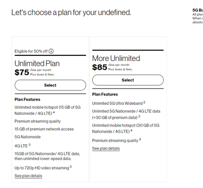

- taimenbaneMar 19, 2024Aspirant
I have the MR6500-100PAS with the latest firmware 12.01.47.00 and I’ve tried it on both the Verizon Unlimited and More Unlimited plans and I still get the APN Error 512.
