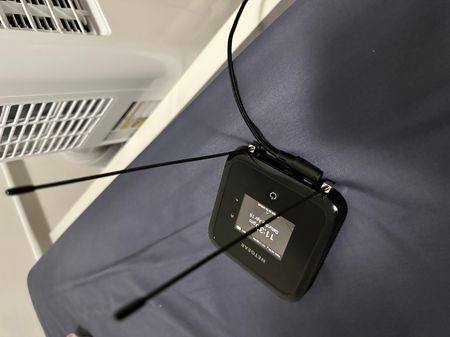

MR5100 no signal without external antennas
MR5100 SKU MR5100-1TLAUS Only works on the external antennas. If it is disconnected from the external antenna, it does not work and a message appears mobile broadband is disconnected. It was working ...
- Apr 15, 2023
Menuka wrote:
Did a factory reset more than 10 times. I also tried updating to the latest firmware. Still could not fix the problem. the router worked fine before installing the external antenna. I just wanted to see if the 5g signal increases with the external antennas.Looks like the external antenna connectors are broken. Without the external antenna, the internal antenna will not have the proper contact if that is the case.
Thanks
John
plemans
Apr 15, 2023Guru - Experienced User
Try a simple factory reset?
Menuka
Apr 15, 2023Aspirant
- JohnPengApr 15, 2023NETGEAR Expert
Thanks
John
- MenukaApr 17, 2023AspirantAs you told me the issue is with the external antenna ports, I replaced both TS9 connectors, but nothing has been changed. Router still works only if an external antenna installed. I guess this may be a software issue. Can someone help me fix this please?
- W1lliamApr 20, 2023Virtuosointernal antenna is not soldered but a flexible contacts, it might be caused by the contacts are loose and that is lead to no internal antenna connected. It is not suggested to open the device by yourself but request for RMA.
