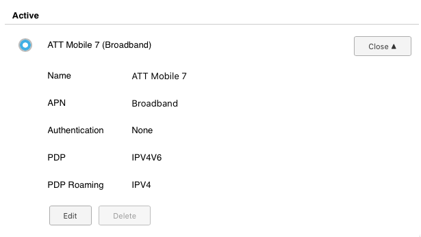

    This is what I see, although I am in the USA so you may very well have something different in Australia.
