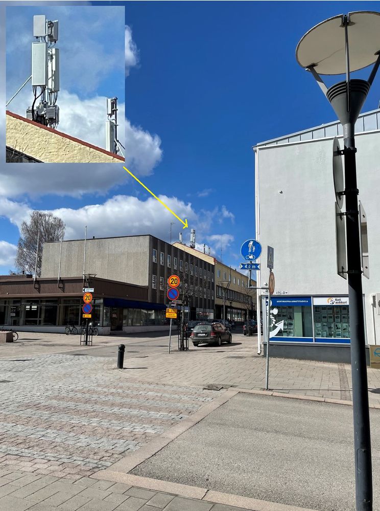

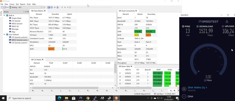

  • Here some fieldtesting photos from last weekend. City of Varkaus, Eastern Finland, new SYV 5G/4G RAN modernized with Nokia technology. M5 takes all from downlink what is possible at the moment.
