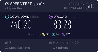

Here is the oddity: (Couldnt complain with this I was shell shocked when it came through. And repeated the test multple times for a few hours on that day with similar results)
My speedtest result from a few days ago : (740M download, 83M Upload) - Speedtest was performed connecting via Wifi 6E both on 5ghz and 6ghz directly to the MR6450.

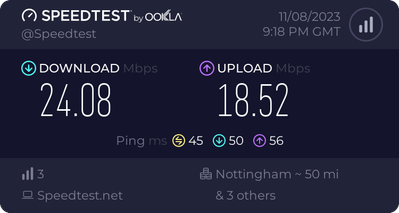

However as soon as I rebooted the router the next time (with the same config, nothing changed) and connecting with no real fluctuation in quality and mode to the Three 5G mast I am consistently getting speeds like this. (Still "5GSUB6")
https://www.speedtest.net/result/15483806830
Occasionally on a few reboots on various days I might get 350M download 40 - 60M upload but this is very rare. And then on a power off and reconnect it will just drop to 20 - 40M again.
