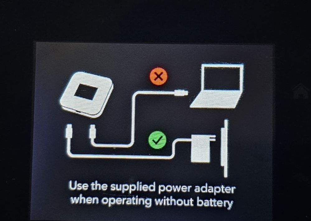

Hi everyone, I want to permanently install a Netgear M6 5G hotspot in my Tesla Model S Plaid 2022.
To do this, I removed the battery and restarted it in the appropriate mode,
As long as the car does not go into sleep mode, everything runs smoothly, but when the car switches off sleep mode, no more power is supplied via the USB C charging sockets.
When I then get into the car, power is supplied again via the USB C socket, but the Hortspot reports that no power is connected.
The following picture appears
Can anyone help me where the error lies?
  • I have now figured it out myself, the two front USB C sockets do not supply enough current, the two rear ones under the screen of the rear seat supply enough current. there is 0.4A there and only 0.2A in the front. so now it works in the back!

  • I cannot see your image but I had a problem getting power via just USB at first with a 'standard' USB connection.  I wanted to use it in our Airstream and the Netgear needs a bit more than just USB.  It works, that I have found, with a QuickCharge 3.0 charger.  I got these (https://www.amazon.com/gp/product/B0779D7DFG/ref=ppx_yo_dt_b_search_asin_title?ie=UTF8&psc=1) and using the QuickCharge 3.0 ports, it seems to work fine.  It has to do an initial reboot to get to the power only mode.
