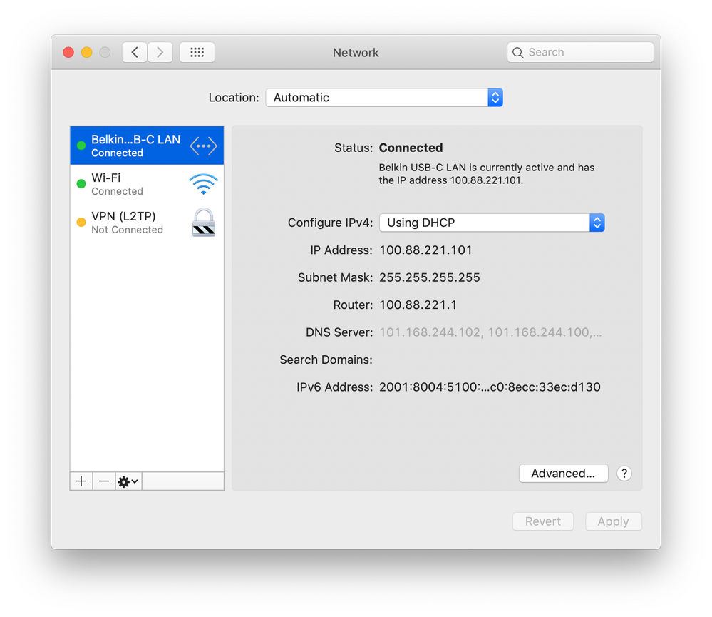

I have aquired a 2nd M5 for testing as the original unit is currently in operational use. This new unit behaves exactly the same way meaning the Admin GUI is not accessible when the device is connected to the WAN port of my router and I'm connected to the LAN side.
If I attach it directly to my laptop when the M5 is in passthrough mode my MacBook gets the WAN address ...
At this point I note that I can access the Admin GUI via either the Router address of 100.88.221.1 or the address configured in the Admin GUI which in my case was changed to 192.168.0.1 (to avoid a conflict with the existing LAN which is already 192.168.1.0/24).
When the M5 is connected to the WAN2 port of my USG-3P I do have connectivity so its operational but the Admin GUI is not accessible.
If I have passthrough disabled I can ping, traceroute, and scan port 80 of the admin address of the M5 but actual http access does not work.
If I have passthrough enabled I cannot ping, traceroute, or portscan the admin address ... either of them. I suspect the subnetmask of 255.255.255.255 may have something to do with not being able to access the passthrough router address (100.88.221.1).
In my situation the Netgear Nighthawk M5 is being used as a replacement for a Netgear V7610 (aka Telstra Business Smart Modem with 4G backup). When that device was connected to WAN2 of my USG-3P I was able to access the Admin GUI. The M5 is behaving differently to what I expected.
