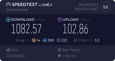

- galvesribeiroApr 29, 2023Tutor
John just to let you know, I got another SIM card from another carrier, Vivo (Telefonica in Brazil). It also works perfectly fine with My Car (as mentioned it has a router built-in), the iPad and iPhone (Personal Hotspot also work) and the Intelbras GS3000 5G router.
I'm losing hope on this NetGear device.
Please advise.
