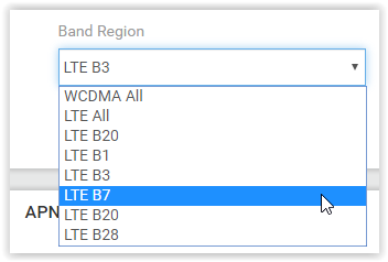

olkitu
Mar 30, 2019Star
Hello everyone!
I wrote now instruction to my blog how to enable band selection for FREE to your Netgear MR1100 router. I have tested that on EU-version but i think should work also US and Australian versions.
https://mt-tech.fi/en/enable-manual-band-selection-on-netgear-mr1100/
For other brands, please check with AT!BAND=? command supported bands because then you see all bands could add to list. Max 8 values possible add only if not remove default ones...

That 5510 TCP is correct port for Telnet. You do no see any output after connected but also no any error. You can then start type AT-commands.

Kuba76 wrote:
Thanks for this. Works great with the ATT version of this hotspot. Is it possible to group bands together? I would like to do band 4,12,30ca. I thought by having it locked on band 66 it would ca that band but it’s just locked on it and I get no carrier aggregation.Yes it's possible. You have to then calculate with NV-calculator.
- MAJOR-z-BOMBASUApr 14, 2019Guide
If you are struggling of how to add custom bands, here is the step by step guide: how to create custom bands (carrier aggregation included)
