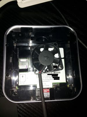

Hi everyone. Just wanted to share a little fun setup I made out of boredom. I found a spare slide switch and a 5V fan in my electronics box and also a 2 AA batteries socket connected in serial. I sol...

It's not as effective as a bigger sized fan with a higher voltage, so it probably only makes a very little difference, but it was mostly just a creative idea to how the heat problems could be solved. In a realistic setup you would either need to remove the cover lid to enable proper ventilation or replace it with an alternative one with holes, and you could attach the fan to the board with a little piece of double-sided bonding tape in the center area.

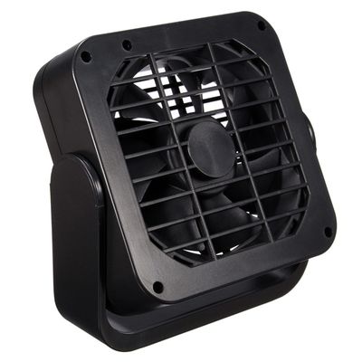

- KarmusDKApr 20, 2018Apprentice
Just ordered this fan. It runs on USB power (5V), so it's not very useful in its current form, but I measured the box and it should fit beneath, so I'll see what I can do when I get it, perhaps tweak it a little bit to make it accept a higher input.

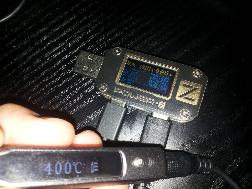

- KarmusDKMay 05, 2018Apprentice
In the meantime I bought this advanced power testing module, that can tamper with both the USB Power Delivery and the QuickCharge protocols to deliver a higher voltage to analog devices, that don't know how to request another input than the default 5V.
A TS-100 soldering iron fully powered by USB-C magic...So if one doesn't want to fiddle with polarity, just buy a capable power bank and force your fan to rotate faster with this nifty little thing. It is possible to go up to 12V on the USB-A plug with QC3.0. For 20V you need USB PD over USB-C.
