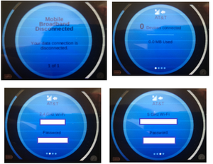

Nighthawk M1 MR1100 will not connect with Keepgo data only SIM
 For some reason I am getting a "Mobile Broadband Disconnected" when using a Keepgo data only SIM.  I can see that the Netgear Nighthawk M1 (MR1100) uses the AT&T tower.  However, it will not allow me...

- krisdev25Dec 16, 2020TutorSure, I have uploaded the model.json file below. This blog will not allow me to attach JSON or TXT files, so PDF. This router is not bound by AT&T. I mean it has been paid for and the contract period has been upheld and has since ended. Therefore, this device is no longer bound to AT&T. Can I enable the firmware update through a REST API and send JSON data to change this setting to update the firmware. Otherwise, is there a command line tool from Netgear to connect to the device and update the firmware, to a generic Netgear firmware instead of AT&T firmware? This is my wish. - krisdev25Dec 16, 2020TutorHere are the instructions for a non-AT&T branded unit (but manual option not available): I've also tried with TFTP with the command below, but not getting error: C:\Users\krzys\Downloads\MR1100NAS_V12.06.11.00_00>tftp -i 192.168.1.1 put MR1100-100NAS_23113828_NTG9x50C_12.06.11.00_00_GenericNA_05.03.secc.spk Connect request failed C:\Users\krzys\Downloads\MR1100NAS_V12.06.11.00_00>
 Need to find another way.- TL_NTGRDec 16, 2020Apprenticekrisdev25 Your M1 Nighthawk is an AT&T model. Under the battery, your product is MR1100-1A1NAS or MR1100-2A1NAS. Given the age of the firmware, your model should be MR1100-1A1NAS. This is configured per AT&T requirements and will not accept FW other than approved by AT&T. No need to continue to attempt MR1100-100NAS_23113828_NTG9x50C_12.06.11.00_00_GenericNA_05.03 As this is for the MR1100-100NAS (Retail unlocked) and is not compatible with your configuration. Have you used this SIM in another device? Are you certain the SIM is active and provisioned and not being rejected by the network? This would cause this Mobile Broadband Disconnect message and is not Firmware dependent.
