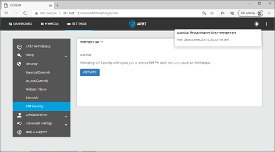

Nighthawk M1 MR1100 will not connect with Keepgo data only SIM
For some reason I am getting a "Mobile Broadband Disconnected" when using a Keepgo data only SIM. I can see that the Netgear Nighthawk M1 (MR1100) uses the AT&T tower. However, it will not allow me...

The device shows: MR1100-1A1NAS. Please take a look at the attached photo.
The support person at Keepgo says that they received messages from my device, but no data. I don't know what that means.
I spent 3 hours with these people changing the different settings. I tried an Android phone with this Keepgo SIM and it doesn't work either. They tell me it is my device settings. Maybe it is because it is a "data only SIM".

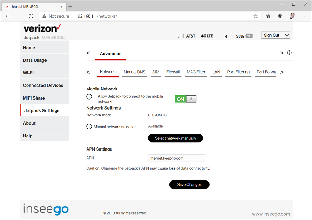

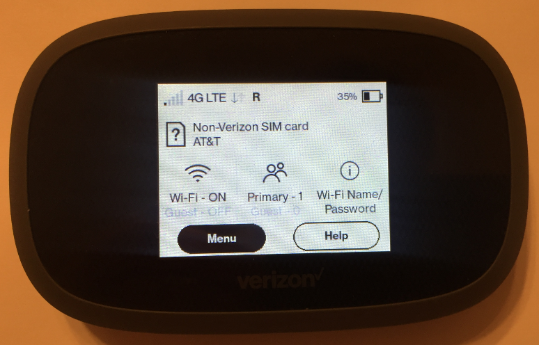

- krisdev25Dec 17, 2020Tutor
Also tried it with Inseego Verizon Jetpack Mifi 8800L. It works as well. It picks the AT&T network automatically.
With this device, I didn't even have to turn on roaming, it automatically connected and showed the "R" symbool. I connected a laptop to the WiFi and right away received Internet.Please take a look at the attached images:

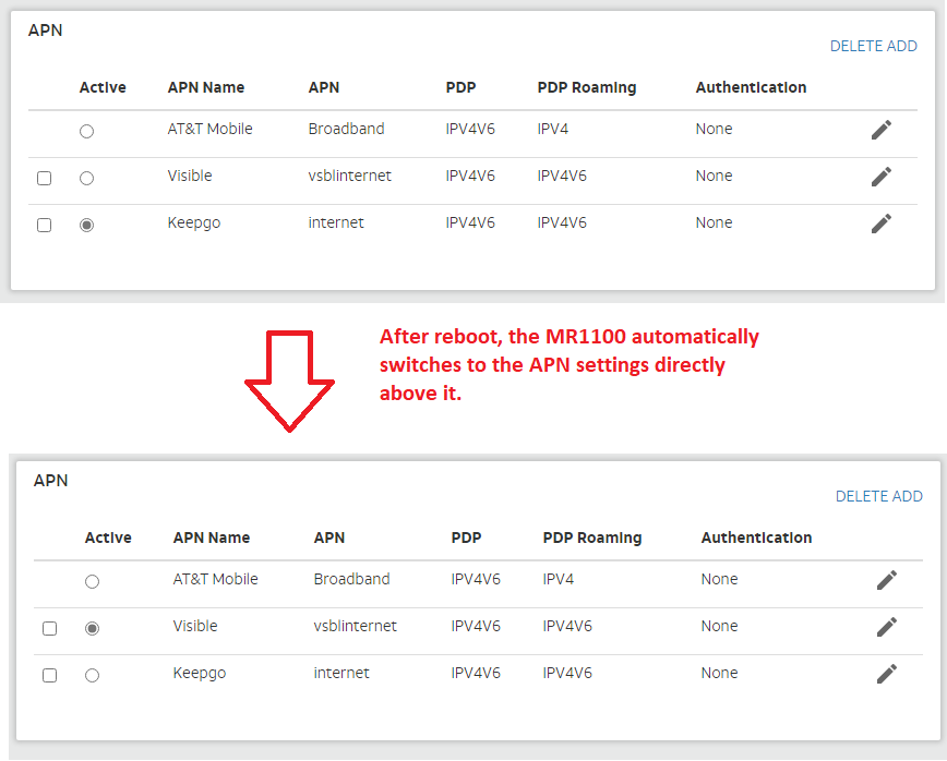

The main issue with the Netgear Nighthawk M1 4G LTE Mobile Router (MR1100) is that is automatically changes the APN setting after reboot. Why does it do that? Why can't it use the "internet.keepgo.com"?

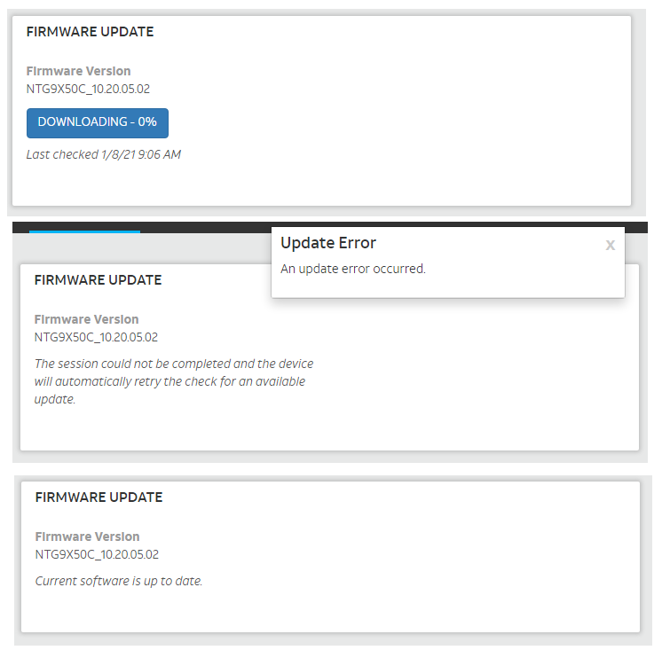

The reason I like this device is because it has a physical RJ-45 connection. - krisdev25Dec 18, 2020Tutor
Current firmware version is: NTG9X50C_10.20.05.02.
AT&T Firmware version available: NTG9X50C_12.05.05.14
When on click on "CHECK FOR UPDATES" it gives me a message "Current software is up to date".
They are blocking the software update. Why is that?

Now, I need to figure out it this has to do with updating the firmware to the latest or unlocking the device. - TL_NTGRJan 04, 2021Apprentice
krisdev25 You are correct. I've tested the older FW 10.20.05.02 on the AT&T MR1100-1A1NAS and observe the same behavior you reported; that the device would not accept the custom APN settings and reverts back to the default AT&T APN profile. I've tested newer AT&T Approved MR1100 FW and the custom KeepGo APN works fine. Upgrading the FW would resolve the issue, however the MR1100 AT&T FW version is maintained by AT&T and there is not a method to locally upgrade.

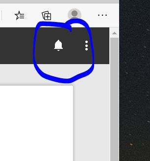

- krisdev25Jan 08, 2021Tutor
It is not locked and also the "bell" just means it has notifications. That is all.
I called AT&T and I have an open technical case with them for the firmware update:
NTG9X50C_10.20.05.02 (old)
NTG9X50C_12.05.05.14 (new)
I've been getting these messages so far with AT&T SIM:"Last checked 1/8/21 9:06 AM"
"The session could not be completed and the device will automatically retry te check for an available update."
"Current software is up to date."
Please take a look at the screenshot of the firmware update messages:
Hopefully, they will be able to push out the firmware update to me so I can get rid of this AT&T branded unit and use the Netgear non-carrier branded unit. - krisdev25Jan 11, 2021Tutor
