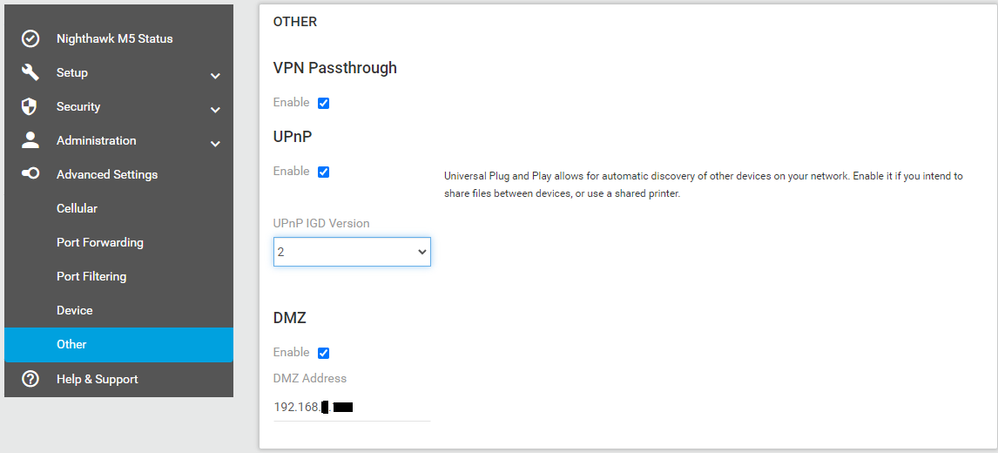

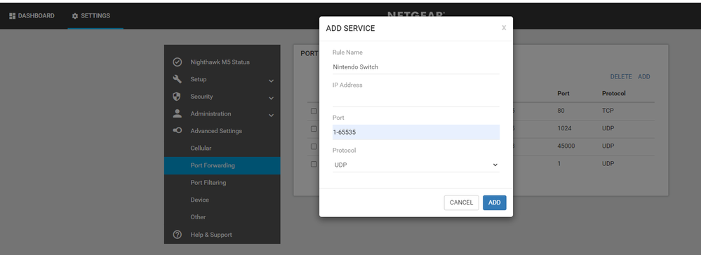

Oh gotcha. I previously checked, and there's only 2 other conversations in this section mentioning Nintendo Switch, and neither one of them got their issue resolved. I tried everything they discussed in their thread, but nothing worked. I even tried Nintendo DMZ guide, but that also did not work:
Does anyone know if I'm entering the port range correctly in the screenshot below?
Does anyone else have any suggestions? I've attached a few more of my screenshots below.

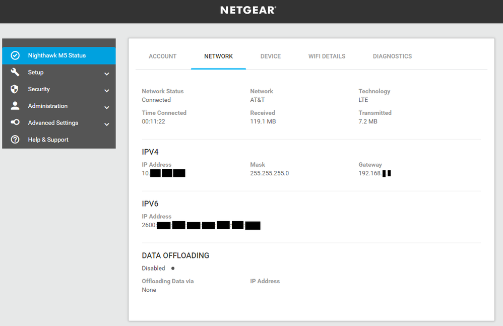

Using a VPN service is a possible workaround.
Checking your screenshots does show AT&T does assign your Netgear M5 a private 10.x.x.x IP address. No blocking at all. This is something virtually all mobile providers do (either using CGN or Private IP) facing the shortage of IPv4 public routeable addresses. Interesting, at the same point we see an IPv6 2600:: prefix - what could indicate a real routeable IPv6 network available, unclear however how big the prefix is and if you could further subnet this prefix any further using internal routers.
Of course AT&T could help - convinced they could offer you a public IPv4 address on your data contract, probably at a certain fee. This should allow a direct NAT type B or A - but I do admit I don't know how good Netgear's mobile router are.
