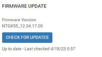

- TmacTradingLtdApr 17, 2023Apprentice
I am on the latest firmware.

Yes. Now you are on the latest. But the FW on your log showed the previous FW version.
