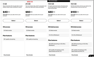

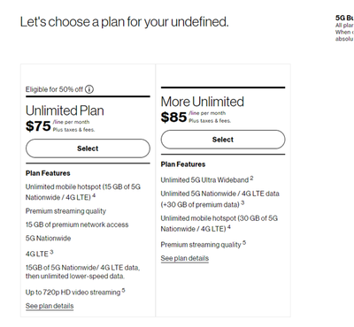

[John] This is the issue I am talking about Verizon data plan. Since your current SIM card is tied to Inseego MiFi 5G UW, you need to visit Verizon store to activate a new data plan with M6's IMEI. Moving the SIM card from Inseego MiFi 5G UW to M6 directly may not work.
We have confirmed that the following Verizon plans can be activated with M6's IMEI.
Post-Paid:
Pre-Paid:
You may also experience other data disconnection issue due to thermal mitigation. I can work with later after we resolve the Verizon data plan issue.
