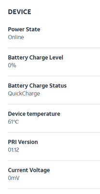

- DaveTastoFeb 09, 2023Tutor
John - it has happened again, dropped signal and had to restart/power cycle:
Please help! Thanks, Dave
- DaveTastoFeb 09, 2023TutorJohn - this temp. was with the battery out, and back cover off (natural convection cooling). No Ethernet plugged in. I appreciate your prompt support. -Dave
- JohnPengFeb 09, 2023NETGEAR Expert
DaveTasto wrote:
John - this temp. was with the battery out, and back cover off (natural convection cooling). No Ethernet plugged in. I appreciate your prompt support. -DaveJust noticed that your device is not on the latest AT&T MR2 release. Could you please do a manual upgrade check on LCD UI to see whether you can get the device updated.
