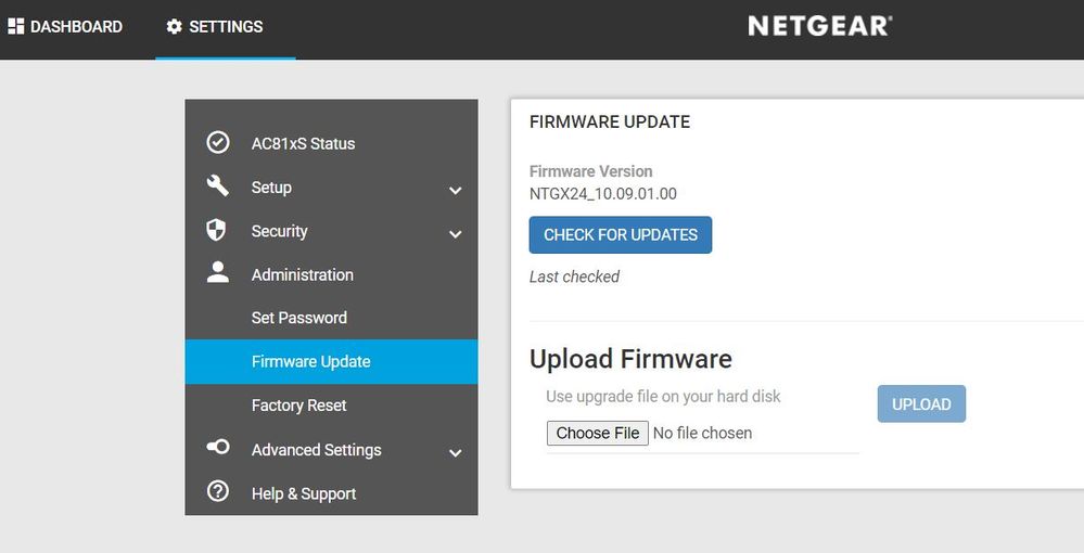

Hi Does anyone know where I can get hold of a copy of firmware for a Nighthawk M2 (MR2100)? My unit seems to have a corrupted firmware version, In the web interface it is displaying unit as A...

- chart69Apr 08, 2021Tutor
Hi
It is a MR2100-1TLAUS
Devuce is powered on with battery installed and plugged into power as well.

Community Team- chart69Apr 19, 2021Tutor
Hi Bianca
Yes the unit was purchased from Telstra.

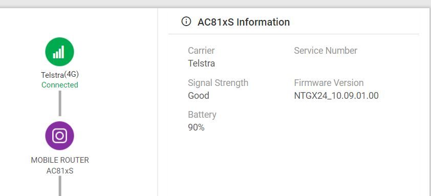

I can go in through tghe web interface (but I have to connect by USB or Ethernet as the wi-fi is disabled) and I can go firmware update and have the option to be able to push a file.
If I do a factory reset (which I had tried previously) I still get the same description for the device (AC81xS) and nothing changed with regards to the diabled wi-fi
I also lose the internet settings totally and I have to manully re-enter these back into the device to get internet access.
