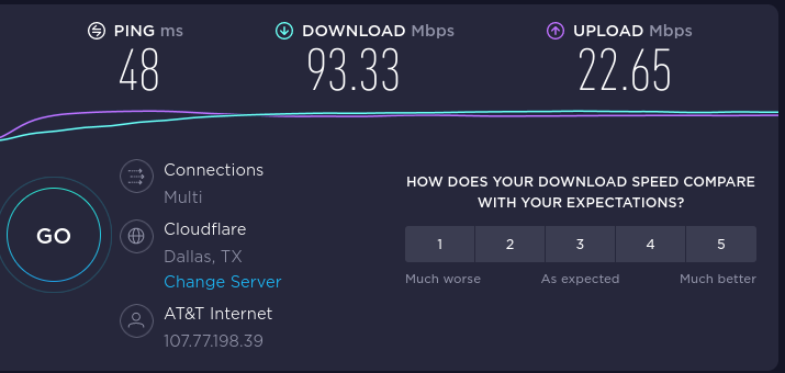

steveXXX wrote:
Hello,
I have had my MR5200 for several weeks now and I LOVE it!
When it works, it works very well:
If I believe one of the apps on my phone, this is from a 100Mbps cell.
When working the status page shows:
Unfortunately anywhere from 10 minutes to several days it goes into this state, and the network no longer works:
Doing a "Reset" doesn't seem to clear it, but a complete "Shutdown" followed by a power cycle (10 seconds off) does.
tia,
Steve

On its own, the M5 is little better than my phone, about 5-10 Mbps downloads.
After I added a: "MIMO 4G/5G Log Periodic Antenna Kit by Waveform"
my downloads increased dramatically to 60-90 Mbps!
I just set the Cellular value to: "LTE and NR5G", getting my faster downloads back.
Will this setting prevent the M5 from falling back to WCDMA and getting stuck in 3G?
tia,
Steve
- JohnPengFeb 10, 2022NETGEAR Expert
tia,
Steve
Yes. Set to LTE and NR5G will prevent the device from falling back to 3G. The drawback for this setting is that if you lose coverage for LTE and 5G, the device will stuck in Searching.
