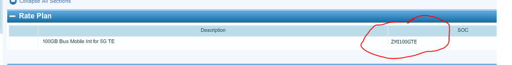

- kristopher_dFeb 15, 2022Tutor
100GB Mobile Internet for 5G devices TE
- JohnPengFeb 15, 2022NETGEAR Expert
Please provide the SoC number following the descriptions.
Thanks
