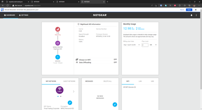

Ok this is Boggling my mind!!
So the Webpage is indicating that the Signal Strength is Excellent yet the device continues to search for the network!!! Is the device purely seeking out 5G? despite being set to all bands?
