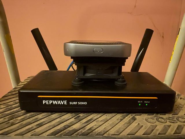

- SFermindiJan 10, 2023Tutor
I have 2 MR1100 units and have experienced same issues. Solution for me is using Anker USB wall charger (with IQ technology, 24w/2 port). Found these at W**mart for less than $20. I run my MR1100s 24x7 as primary rural internet connection without battery installed to avoid decomposition. Being able to run hotspot without battery is critical and great feature of MR1100. However when charging the battery, MR1100s will quit charging at ~30% due to heat issue. Solved this issue by using USB powered fan by AC Infinity which sits perfectly under MR1100. I've monitored MR1100 temp from Admin app and it works great.
