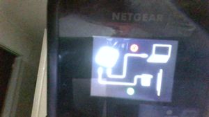

Running the Nighthawk MR6110 on AC power
I've removed the battery after powering off. When I connect the USB cable the Nighthawk will not start. It shows a screen like it is looking for an Ethernet cable. I've done a factory reset and gone ...

Dec 01, 2022Aspirant
This is a better photo of what I get on the Nighthawk screen when I connect the usb cable

Yes I have the same challenge. The diagram shows that it must be plugged into the supplied AC power pack. The mystery is that the AC power pack has a usb output so logically plugging into a normal usb should be ok. So the 6110 must be able to detect that it’s connected to AC?
- W1lliamMar 09, 2023Virtuoso
you will need to have a cable that supports QC3.0, with good power adaptor supplies sufficient current to MR6110 in order to get rid off the battery, check the specs for the power adaptor on its USB-A capacity if the current can be supplied more than 3A, I've tried with 5V/4.5A though, it works.
