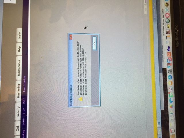

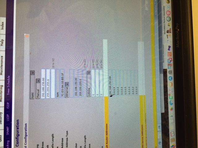

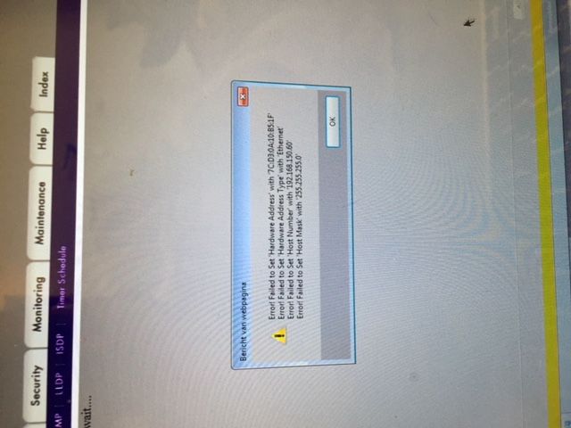

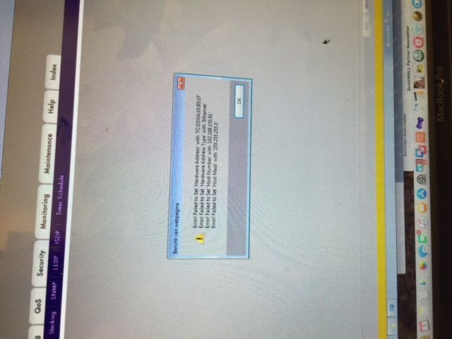

Hallo,
I want to create a  static mac adress binding table. I do this at the  DHCP Pool configuration. But when I choose for the binding type manual it safe's the configuration but does not work. And when I want to modify the configuration i get an error popup messages that the harware adress is not correct and also other error messages. But the mac hardware adress is correct and no matter what I try it doesn't change it anymore.
Can sombody help with this? I have the latest firmware 10.0.0.53
Kindly regards,
Ralf

    I suggest you to try to reboot the GSM7352Sv2 switch and check if the same problem will occur.
    Kindly post a screenshot of the error message that pops up if ever the same problem occurs.

      erroronce SafederrorErrorThanks for the replay. I rebooted it but it the problem remain.
      • Ralfes's avatar
        Ralfes
        So the static mac binding doesn't work even after reboot. And when I would like to modify it, I get the error.

      Thank you for the feedback.  The images are small and if I enlarge it to read the error message, the images get pixelated.
      Kindly try to configure a DHCP Pool Manual Reservation via the console connection to the GSM7352Sv2 switch.  As reference, read pages 336-338 of the GSM7352Sv2 Software Administration Manual here.   You may want to try again setting up the DHCP Pool manually via the web-GUI by following the steps indicated on the manual.
      To connect a console to the switch, read the instructions on page 26-27 of the GSM7352Sv2 Hardware Installation Guide here.
      Let us know the results.
