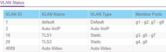

With the 308T switch, I created two VLANS with IDs 10 and 20. Here is the initial configuration:
VLAN 1
g1-g2, g7-g8 untagged
VLAN 10
g3, g5-g6 untagged, g7 tagged
VLAN 20
g4 untagged, g8 tagged

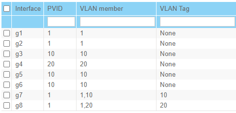

The PVID assignments are as follows:

# Set PVID of ports g5-g6 to 20.
snmpset -v 2c -c COMMUNITY 192.168.1.2 1.3.6.1.2.1.17.7.1.4.5.1.1.5 u 20
snmpset -v 2c -c COMMUNITY 192.168.1.2 1.3.6.1.2.1.17.7.1.4.5.1.1.6 u 20

After the above commands, everything is as expected except ports g5-g6 are still untagged members of VLAN 10. I’ve tried switching the order of the last two commands (set untagged then egress) but still end up with unexpected results.
Any idea what I’m doing wrong?
