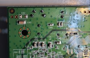

Looks like intentional design for a part but wasn't soldered in place for this model. Doesn't look broke off or anything.
