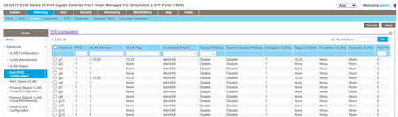

GS324TP S350 unable to obtain IP from unifi USG3 and UAP-AC-PRO
Hello everyone, I have been trying to configure multiple vlans to be accessible on my unifi AP. I read similar post where people indicated they were successful, however I have not been lucky enough t...

Hi schumaku,
thanks for filling my knowlege holes :-) and helping me out here.
I do have, the DM and AP on PVID 1 and [U]ntagged for VLAN1
All the other VLANs are Tagged on both ports, my assumption was that this would be a transparent way through the switch, as a direct connect to the AP to DM on the same DM Port works fine.
The AP continuously restarts with "Isolated/Restarting/RFScanning" state. The IP seems to be assigned now.
I'm lost, and the guy I pay for handle my Network suggests to buy a new switch from unify. I don't want to do this. :-(
Is there a diagram, video or anything out there explaining how the AP and DM communicate, and what kind of traffic needs to be enabled in order they could find and like each other?
schumaku
Jul 09, 2021Guru - Experienced User
Yet another issue that is not a Netgear problem - your config looks fine based on the description, but I would double check things 8-)
Reads to me your APs can't reach the UniFi controller - this is either a the UniFi Cloud Key or the DM - is why ever not reachable, or does hang around in another VLAN and/or IP subnet. Again something that should reside on an untagged VLAN 1 by rule of thumb. Also check the APs (without a tagged management configured - just in case) VLAN and the controller are really on the same subnet (and VLAN).
