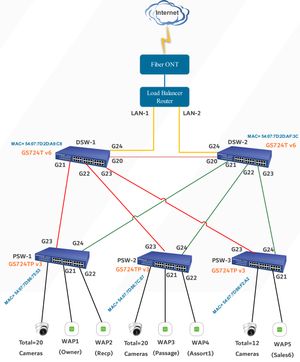

Hello, In a network scenario, we have total 5 Netgear switches. We have 2 GS724Tv6 switches and 3 GS724TPv3 switches. Check the topology below: When we implemented this design, I found that on...
- Apr 24, 2025
Taking control of STP (resp the preferred RSTP) is the key here, and not leaving the switches on the default priority.
DSW-1: 4096
DSW-2: 8192
PSW-1: 40860
PSW-2: 44965
PSW-3: 49052
Does that load balancer participate in STP/RSTP? If yes, enable and configure it accordingly:
LB: 4096
DSW-1: 8192
DSW-2: 12288
PSW-1: 40860
PSW-2: 44965
PSW-3: 49052

- samarthengineerApr 24, 2025Aspirant
Hello schumaku
According to STP's root-Bridge Election criteria:
1. Switch with the lowest priority
2. If priority is same, switch with the lowest base MAC address
So if you check arrangement of switches here in my topology, I have placed switches accordingly.
DSW1: 54:07:7D:2D:A9:C8
DSW2: 54:07:7D:2D:AF:3C
PSW1: 54:07:7D:86:75:53
PSW2: 54:07:7D:86:7C:07
PSW3: 54:07:7D:86:F2:A2
Load Balancer Router: A8-6E-84-21-99-56
Based on this, DSW1 should be root-bridge. So is this mandatory to change the priority of the switches?
And if I remove, load balancer router from the topology (considering it does not participate in STP), still have I to change the priorities?
Regards,
Sagar Patel
- schumakuApr 25, 2025Guru - Experienced User
Yes, you are on the controls - I'm not.
Strongly suggest to take control of (R)STP priorities, see my basic (R)STP proposal(s) for your environment. It's not complex, but for my part I would never depend on the default STP setting -and- "lowest MAC" [a standard in (R)STP].
There was a lengthy thread (not covering such a redundant network setting when I remember right) years ago here worth reading and understanding by Jedi_Exile (hope he is still around 8-) ). For most "simple" networks, deploying (R)STP is sufficient, especially in case you are unsure about the other devices (like other brand switches, load balancer, ....).
Sure, more sophisticated designs can be considered, including MSTP based approaches - all this requires -full- control and -knowledge- over almost everything. That's what we as network engineers are paid for, including experience, ... because our manager and Cxx level leaders depend on us. (My best wife would love to hear that, and so do all my customers CEOs)
