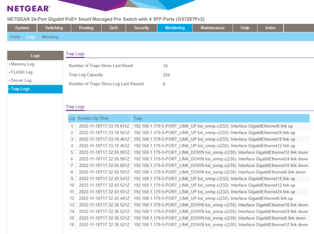

Hello, hopefully you can help me. The last few days ive installed a GS728TPv2 which power four Ubiquiti u6-pro access points. The cable to each one is cat6a and the cable tester said all is good. W...

Just an update. On the section where it lists all the poe port states. Only one evr says delivering power, the othere 3 ports just say searching. When it plays up often the port that says is delivering power would change to another one. I've found when I do a speed test, some times you will see the speed build up and then just drops out and the test fails. But all the access points start flashing live the power has glitched.

ive looked at the System > PoE > Advanced > PoE Port Configuration screen and only one port (only for poe devices and one back to the switch) ever said drawing power, the rest said searching. I hadnt change any of the default poe settings that the switch is supplied with. One thing though was if i unplugged the device that was listed as drawing power then the screen would update one of the other three that where still plugged in and mark that as drawing power.
Here a complete screenshot with one active PD (AP) would be interesting to see.
