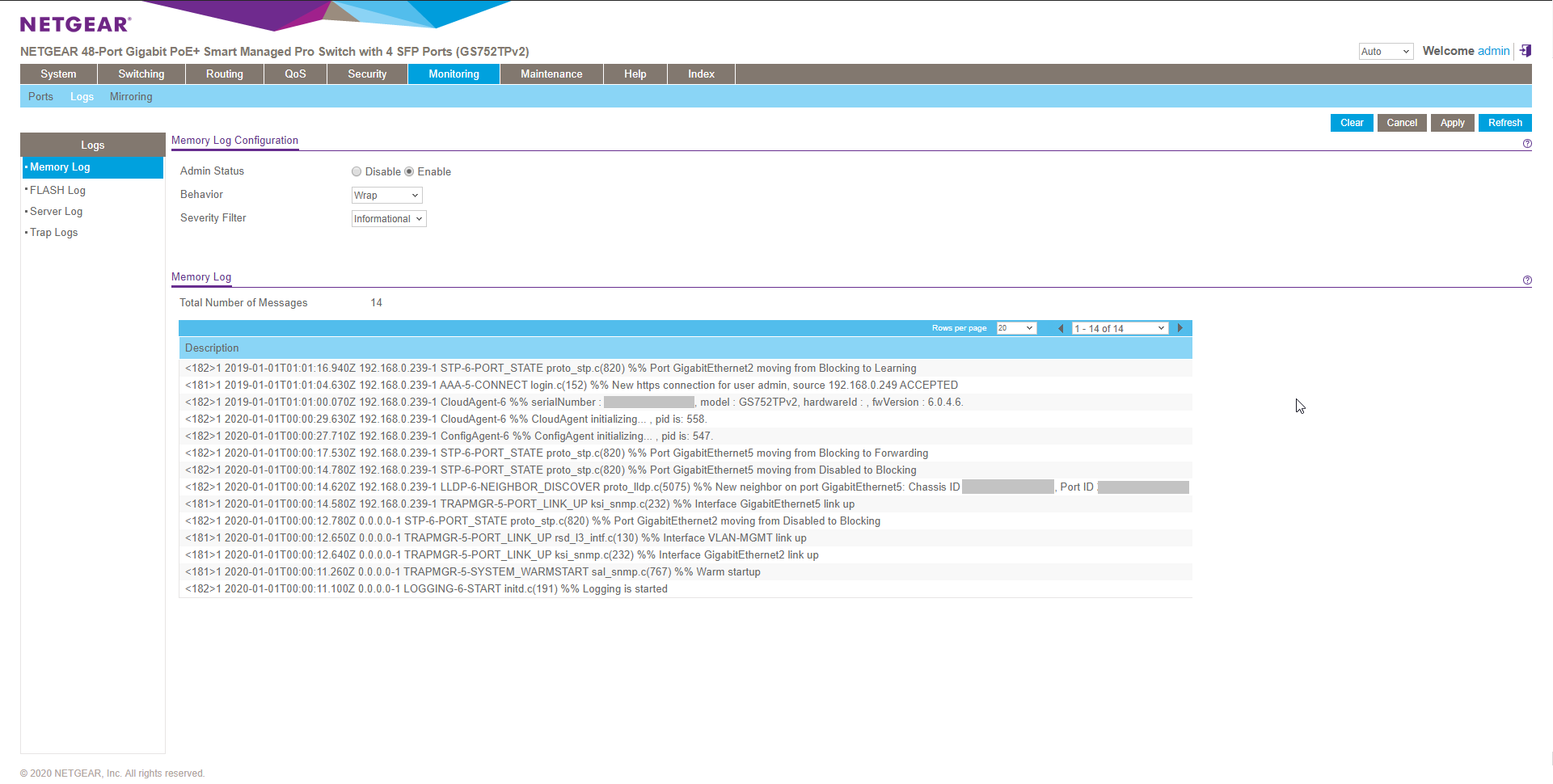

On monitoring logs, I don't have "Buffered Logs". I attached memory logs but I don't see anything weird in it.
