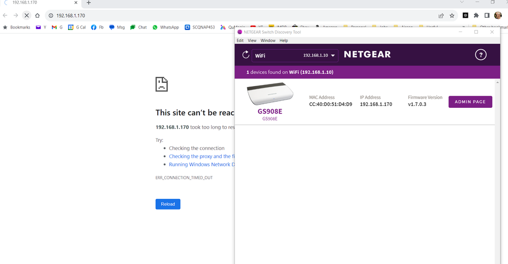

- SpencerChristopAug 24, 2023Tutor
Even using the Netgear Switch Discovery Tool, I can see the device but not connect to it.
