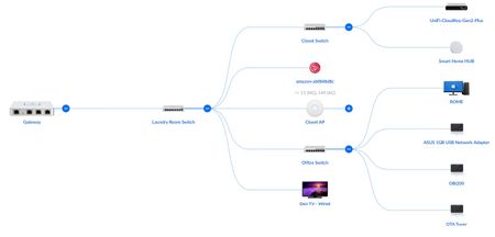

ProSafe GS108Ev3 VLAN failure
Below is my network setup. Gateway: Ubiquiti UniFi Security Gateway 3P (USG-3P) Port 1: WAN (Internet) Port 2: LAN (Trunk port, Untagged VLAN1 and tagged VLAN13 and VLAN15). Laundr...

Well, I guess more tests need to be done. Simplify the configuration for that. Best, start with connecting the NETGEAR switch directly to the Unify gateway and use your laptop connected one by one to the access ports to each VLAN in the switch. I have never owned any Unify product, so I don’t know how they work with NETGEAR switches. However, I successfully used NETGEAR switches (802.1Q VLAN configured) with various D-Link, TP-Link, Netgate and CISCO VLAN-aware products.

I found the problem. The configuration of the VLANs on the Unifi router was different than the Netgear switch.
Subnet
| Subnet | VLAN Unifi | VLAN Netgear |
| 192.168.13.0/24 | 3 | 13 |
| 192.168.14.0/24 | 4 | 14 |
| 192.168.15.0/24 | 5 | 15 |
After changing the VLAN on the Netgear switch, all tests pass!
Thanks everyone
