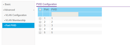

Hi there I'm building a network right now and I'm configuring my switch on which leads to the router and then into the network. Short questions about the VLAN: A) Have I configured the VLANs corre...

A) Have I configured the VLANs correctly? (see pictures)
The pictures require some moderation before becoming visible - standby.

Assuming you make use of 802.1Q Advanced settings - because somehow you need to connect all the VLAN to a router, what typically does happen by a VLAN trunk, inlcuding all VLANs. With a PVID 4 set on the port, and set the port to [U] for VLAN ID 4, and no other VLAN being a member of this port - yes, this port does just connct t the VLAN ID 4. And of course, each VLAN must have it's own TCP/IP subnetwork, maintained and supported ie by a DHCP server, from the router. To have the printers discoverable from the client (PC, Mac, mobile device, ....), to have printers reachable from the other VLAN(s), router and the firewall rules must be set accordingly.
Putting printers to a dedicated VLAN does make sense only on a bigger managed environment, where all printing and queueing is handled on a server. For work group or direct printing, this i not the greatest idea. It will mostly prohibit printing from mobile devices like iOS or Android, too.
Tell us a little bit more on the environment (ie. router, servers, VLAN plan, ...).

A) So are these configurations enough for VLAN on the switch or does it require more?
B) Yes I will set some firewall rules

Try to tie Zones, VLANs, and TCP/IP subnetworks together.
While your approach might be well secure, it might be unhandy, depending on the usage again. A "hundred" years ago, where the wireless was for surfing the Internet, and probably accessing some internal mail servers, plus an Intranet server, this set-up was state-of-the-art.
Today, you want the WLAN for your trusted devices, the LAN, NAS, and printers very near together - easily discoverable services, ad-hoc access to the services, say to a multi-function-device form a mobile phone to scan some document pages.- neverbesuccessfJan 13, 2018AspirantCan I tie up the Zones, VLANs abd Subnets on the router or on the switch. And how can I do this? How can I „connect“ them? Dont really understand this to be honest
And B) Is this correct and safe with the firewall rules?
C) Do you know how I configure virtuelle machines like a client for the VLAN on a physical switch?

4: PrinterThis is what I was talking ref. tie up - wiht a single LAN zone, keep PC, printer, WLAN (your trusted devices), use a single VLAN. Sorry for the confusion.
- schumakuJan 14, 2018Guru - Experienced User
Ref. the VMs ... it depends on how the interfaces are configured - on the virtualisation host as well as on the VM itself. A system can handle just an untagged network, or multiple services which can talk or offer services to multiple VLANs can be configured for tagging (multiple virtual interfaces), so the port can be either dedicated to one VLAN (untagged), or as a VLAN trunk handling access to multiple VLANs.
