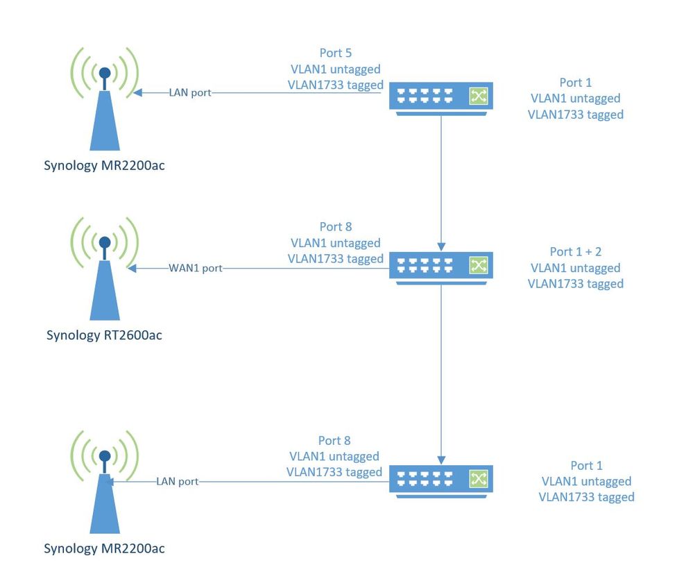

- ppcinaApr 06, 2021Aspirant
because it doesn't work in my case, i drew a picture and please check if it's OK
- ppcinaApr 16, 2021Aspirant
I configured port as described above and finally Guest WiFi is visible. Unfortunatelly devices connected via AP MR2200ac are not getting correct IP address and are not connected to internet. Do you have please any idea why it could be?
Thank you Petr
Thank you very much for help. WiFi finally works.
