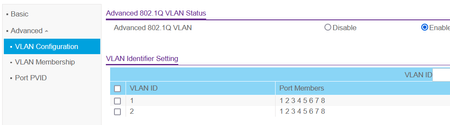

US-16-150W + GS308E + IP Cam on vLan 2
Hello, I have a UniFi US-16-150W switch which I've had to extend with a another switch GS308E in the garage. I've connected an IP Cam (Reolink RLC-511) to the GS308E and also have a direct conne...

The issue I'm having is that the IP Cam connected to GS308E is not being recorgnised in VLan 2.
I've set the ports to have vLan enabled on them and also set the PVID to port 3 (camera port) and it does not work. The camera just does not get recorgnised on vLan 2 but s fine on vLan 1
For a simple flat untagged network extension, keep the GS308E config on the VLAN 1 config, and don't play with PVIDs without some basic VLAN know-how.
With defining the PVID 2 on the port where you connect the camera, you tell the switch to associate the untagged frames with the VLAN 2 - which does not exist, neither on the GS308E nor on the uplink (trunk) config on both sides. Of course, this can't work.
