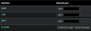

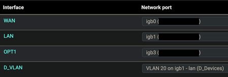

VLAN problems with GS324TP and pfSense
I'm struggling to get a single VLAN working. The setup is pfSense router at 192.168.1.1 that connects to the Netgear switch. I created a VLAN (tag 20) and configured it and the firewall rules using s...
JeraldM
Aug 31, 2022NETGEAR Employee Retired
Welcome to the community!
Assuming that the firewall is connected to port 15 of the switch, it should be marked as Tagged for VLAN20 and leaving the rest as the default where VLAN1 is marked as Untagged and the PVID as well.
As for connecting the client devices, remove the Untagged port on VLAN1 then mark the same port as Untagged on VLAN20.
For your reference, you may check this KB article and see sections Create VLANs on the switch, Add ports to the VLANs, and Configure port PVID settings for untagged ports.
Regards,
JeraldM
NETGEAR Community Team
