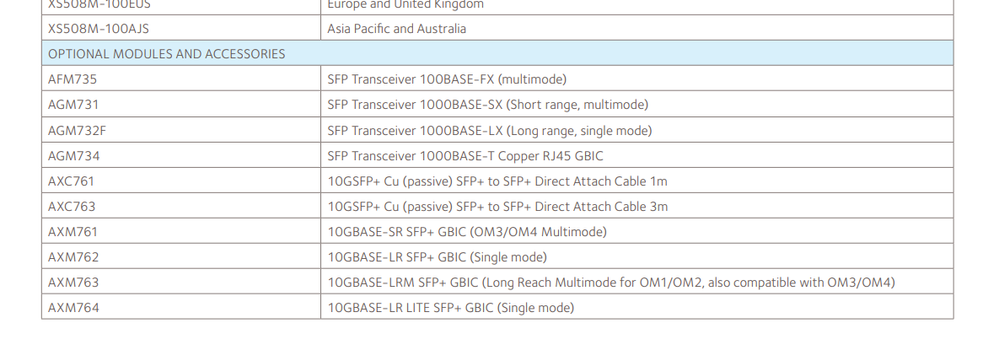

Very likely. A good starting point is always the switch datasheet with the supported modules and model types listed:
Source: https://www.netgear.com/jp/media/XS505M_XS508M_DS_tcm171-59932.pdf

Do I need this? https://www.netgear.com/business/wired/switches/accessories/axc761/ ? Will this definitely fix it?
schumaku
Sep 17, 2025Guru - Experienced User
